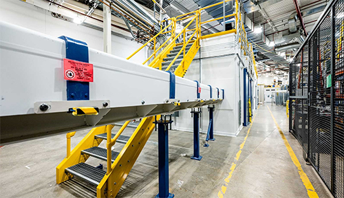

But now an upgrade of the APS is in the works, one that will increase the brightness of the x-ray beams it generates by up to 500 times. The upgrade requires this spectroscopy research to coalesce and move to the previously empty Sector 25, which has been updated and rebuilt for that purpose. The move is partially driven by the nearly 600-foot-long High Energy X-ray Microscope (HEXM), a much anticipated instrument that will be built at Sector 20 and extend into the recently completed Long Beamline Building.

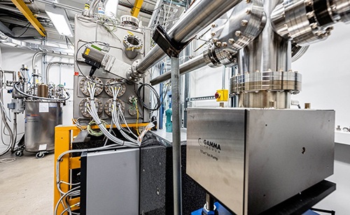

Traditionally, advanced spectroscopy at Sector 20 has offered multiple scientific tools, including the LERIX spectrometer. (LERIX stands for lower-energy resolution inelastic x-ray scattering.) Going forward, the program will continue these efforts and also share space in Sector 25 with ultrafast spectroscopy programs previously located at Sector 7 and Sector 11. However, the programs won’t share a beamline. Sector 25 will use canted undulators – two separate x-ray sources providing beams separated by a small angle – to split a single beam for use at two independent beamlines.
The upgraded beamline designated ASL (for Advanced Spectroscopy and LERIX) will offer high-resolution images with roughly 100 times greater intensity than those currently generated at Sector 20.
