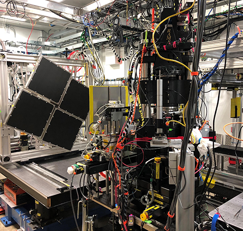

In 2011, the team identified the need for a sophisticated load frame to enable advanced HEDM characterization of Air Force relevant engineering materials. In a partnership with, PulseRay, they invented and developed a family of new materials testing load frames known as Rotational and Axial Motion Systems (RAMS). Four versions of these load frames were developed with increasing complexity, which are the first-ever materials testing systems designed to simultaneously load and continuously rotate a specimen.
In 2012, the team delivered the first RAMS system to the APS as an insert in a traditional load frame. This led to the first dataset combining multiple synchrotron x-ray techniques during simultaneous mechanical testing.
While partnering with CHESS, in 2014 AFRL funded $1.1 million to upgrade a beamline to enable HEDM experiments at the CHESS facility. The funding paved the way for RAMS 2, the first standalone RAMS load frame.
In 2016, the team delivered the RAMS 3 system to the APS, which incorporated both axial loading as well as torsional loading testing ability. Pratt & Whitney, Rolls-Royce, and General Electric have all used the system to examine the initiation and propagation of cracks in aerospace alloys.
In 2018, the team was awarded a patent based on the concept of continuous rotation of the sample while under axial or torsion load. RAMS 4 is currently under development and is scheduled to arrive at CHESS and AFRL this fall.
The RAMS systems have been used in over 30 beamline experiments by 3 Air Force engine manufacturers, 10 universities, 6 national labs, and 2 international partners.
